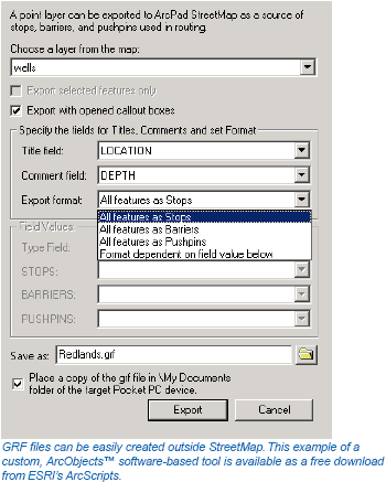

You may want to create a custom tool that reads point features and saves the attributes automatically into the appropriate XML elements in the GRF file. A sample illustrating how you can create such a custom tool is available on the ArcScripts Web page (www.esri.com/arcscripts). To find the example, type “grf” in the keyword field. This sample has a tool that can be added to ArcMap, which will then allow you to create a GRF file based on a point layer in your map. The GRF file can then be added to ArcPad.
