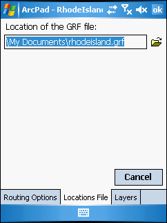

Locations File
The Locations, or GRF file contains saved information about geocoded addresses, calculated routes, and driving directions. The GRF file is dynamically maintained—the content of the file is automatically updated whenever you add or remove a stop, pushpin, barrier, or change their properties, or calculate a route.
You can send this file to a colleague with whom you want to share information. You can also load a GRF file for use in StreetMap. The GRF file provides a convenient method for receiving and sending stops and routes for use in ArcPad.
For more information about the Locations file, see the StreetMap Geocoding and Routing File section that follows.

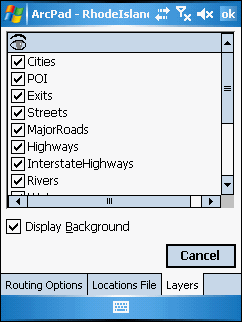

Layers
If your map is becoming too cluttered with details that are unimportant to you, you can make layers invisible on the Layers page. Simply uncheck the check boxes for the layers that you don’t wish to see (e.g., railroads, landmark boundaries, and counties).
