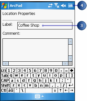

You may decide that you don’t want your callouts to show the address of the location; you would rather want it show other information, such as custom titles or comments. With StreetMap you have the option to edit the labels for locations.
  1. Tap and hold the callout or symbol for a stop, pushpin, or barrier.
  2. Tap Properties in the context menu.
  3. Use the soft keyboard to type a new label.
  4. Tap OK.
    The new label appears on the map.
