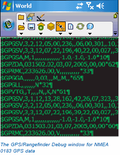

GPS Debug information for the NMEA 0183 protocol
If you are using the NMEA 0183 protocol, you should see the NMEA 0183 sentences displayed in the GPS/Rangefinder Debug window as ASCII text. Each NMEA sentence that ArcPad reads from the serial port is displayed in the GPS Debug window. Valid GPS data is displayed using green text, while invalid GPS data is displayed using red text.
The displayed NMEA 0183 sentences can be used to troubleshoot your GPS connection. In the following example, a number of the NMEA 0183 sentences are displayed showing empty fields with commas and no preceding information.
For instance, the $GPGGA sentence (in the middle of the GPS/ Rangefinder Debug window) is displayed as:
$GPGGA,,,,,,0,03,,,M,,M,,*65
The $GPGGA NMEA 0183 sentence includes the GPS fix data, with the first field containing the UTC time, the second and third fields containing the latitude, the fourth and fifth fields containing the longitude, the sixth field containing the fix quality, and the seventh field containing the number of satellites being tracked. In the above example $GPGGA NMEA 0183 sentence, the UTC time, latitude, and longitude values are empty. The fix quality field is 0, which means there is no GPS fix. The number of satellites being tracked is 3, which is insufficient to calculate a position (4 satellites are needed to calculate a position. So the absence of latitude and longitude values and the fix quality of 0— that is, no fix—indicate that the GPS receiver has not locked on to sufficient satellites to calculate a GPS position and consequently is not outputting a GPS position to ArcPad. This would explain why, in this situation, ArcPad does not display a GPS position in the GPS Position Window.
Similarly, empty fields in other NMEA 0183 sentences can explain why the corresponding information is not displayed in the GPS Position Window.

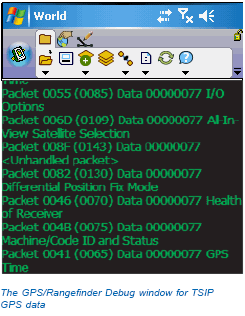

GPS Debug information for the TSIP protocol
The TSIP protocol is quite different to the NMEA 0183 protocol. First, the TSIP protocol is a binary protocol in which the GPS data is sent in a binary format as data packets of information. This binary data is illegible and needs to be decoded by a computer program. Consequently, the TSIP packet contents are not shown in the GPS/Rangefinder Debug window, but instead a message is displayed showing the TSIP packet number, a description of the contents of the packet, and whether ArcPad has received the packet without errors. Packets that have been successfully received are displayed using green text. Packets that have not been successfully received are displayed using red text.
Second, with the TSIP protocol, some of the GPS data is only sent by the GPS receiver when it receives a request to do so. For example, ArcPad needs to send the TSIP packet 0x003C, Request Tracking Status, to the GPS receiver to receive the packet 0x005C, Satellite tracking status, in return.
In the example above, all of the TSIP packets have been successfully received, and are all displayed using green text.
The TSIP packet messages in the GPS/Rangefinder Debug window can be used to troubleshoot your GPS connection in the same way as the NMEA 0183 sentences. Missing information in the GPS Position Window can usually be explained by a TSIP packet that ArcPad has requested but has not yet received.
