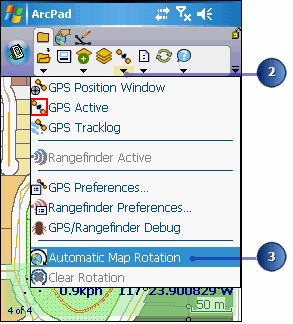

  1. Activate your GPS if you have not already done so.
  2. Tap the drop-down arrow below the GPS Position Window button.
  3. Tap Automatic Map Rotation.
    As you begin to travel and change directions, ArcPad will automatically redraw the map so that the direction of travel is always up.
