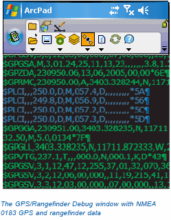

GPS/Rangefinder Debug is a useful tool for troubleshooting GPS and rangefinder connection problems. The GPS/Rangefinder Debug tool is opened by tapping the arrow below the GPS Position Window button and then tapping GPS/Rangefinder Debug. The GPS/Rangefinder Debug tool is only opened when a GPS or rangefinder is currently active.
The GPS/Rangefinder Debug tool opens a window that displays data from either the GPS receiver or rangefinder, or both. Valid GPS data is displayed in green text, and valid rangefinder data is displayed in blue text. Invalid data is displayed in red text. Valid data is data that is constructed properly, in accordance with the selected GPS or rangefinder protocol, and has a valid checksum.

Most rangefinders output data as ASCII text. Some rangefinders output data using the NMEA 0183 protocol, which is also an ASCII based protocol. In either case, you should see the data from the rangefinder displayed in the GPS/Rangefinder Debug window as ASCII text. Each data string or NMEA sentence that ArcPad reads from the serial port is displayed in the GPS/ Rangefinder Debug window. Valid rangefinder data is displayed using blue text, and invalid rangefinder data is displayed using red text.
The displayed data can be used to troubleshoot your rangefinder connection. In the example on the previous page, a number of NMEA 0183 sentences from a GPS and a LaserCraft Contour XLR rangefinder are displayed. For instance, the rangefinder $PLCI sentence is displayed in blue text as:
$PLCI,,,250.0,D,M,057.4,D,,,,,,,,, *5A
Using the documentation for the LaserCraft Contour XLR, we can determine that the bearing is 250.0 degrees, and the inclination, or pitch, is 057.4 degrees. The fields for distance, or range, are empty indicating a possible problem with the measurement taken with the rangefinder. In this case, the distance fields are empty because the target was within the minimum range.
