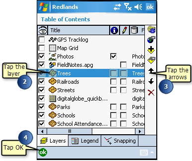

  1. Tap the Table of Contents button.
    The Table of Contents opens on the Layers page and displays a list of the layers that have been added to your map.
  2. Tap the layer whose order you would like to change.
  3. Tap the arrows to change the order of the selected layer.
  4. Tap OK.
