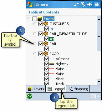

  1. Tap the Table of Contents button.
  2. Tap the Legend tab in the Table of Contents.
  3. To display/hide the details of a layer’s symbology, tap on the plus/minus, +/-, symbol next to the layer name or double tap the layer’s icon.

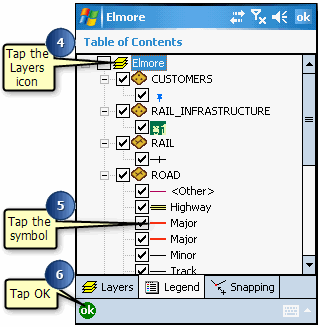

  4. To open the legend for all layers, tap the Layers icon at the top of the legend.
  5. To view a symbol’s properties, tap on the symbol.
    The Symbol Properties dialog box opens and enables you to define the simple or complex symbology.
  6. Tap OK when you are finished.
