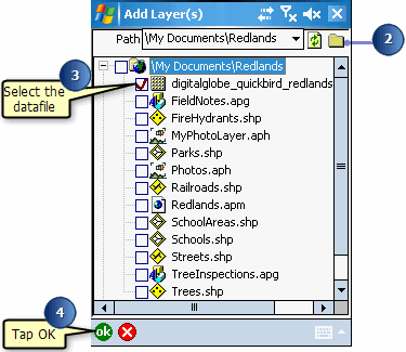

  1. Tap the Add Layer(s) button on the Main toolbar.
  2. Tap the Folder button to navigate to the raster image you would like to add
  3. Check the checkbox beside the datafile(s) you would like to add.
    A red check mark indicates selected files.
  4. Tap OK.
    Your images are now added as another layer to the existing ArcPad map.
