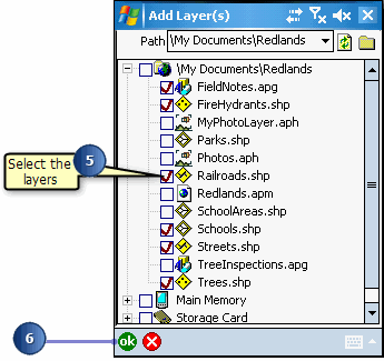

  1. Tap the Add Layer(s) button on the Main toolbar.
  2. Tap the Folder button to navigate to the directory that you would like to add data from.
  3. Tap the folder in the Directory Browser dialog box that contains the layers you wish to add to your map
  4. Tap OK.
  5. Check the check box beside the datafile(s) you would like to add.
    The Add Layer(s) dialog box only displays layers that are supported by ArcPad. A red check mark indicates selected files.
  6. Tap OK.
    Your data layers are now added to the existing ArcPad map.
