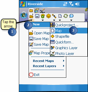

  1. You can also open a new map from the Main toolbar in ArcPad. Tap the drop-down arrow below the Open Map button.
  2. Tap New
  3. Tap Map
    ArcPad will open a new blank map. If you have another map open, ArcPad will ask you if you would like to save any changes to the current map before closing it.
