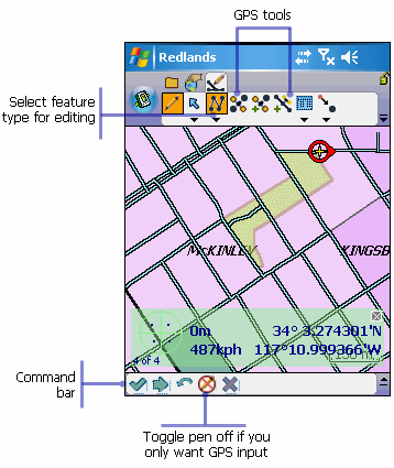

Editing in ArcPad with a GPS is very similar to editing with the mouse pointer, pen, or stylus; the main difference is that the GPS is the source of coordinates instead of the mouse pointer. Using the incoming GPS coordinates, you can capture point, polyline, and polygon features. You can also move existing points and vertices to the current GPS position.

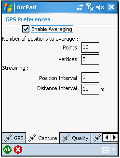

You can also specify the position interval, or frequency, and distance interval of GPS position coordinates for ArcPad to use when capturing polyline or polygon vertices in streaming mode.

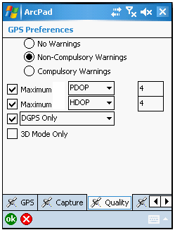

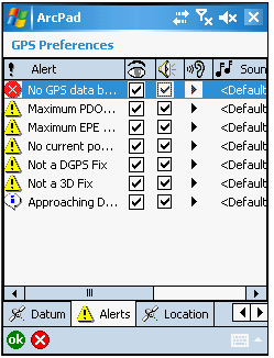

The GPS Quality, Alerts, and Capture options are all specified in the GPS Preferences dialog box. These options are discussed in more detail in section, Creating new features with a GPS', and in the ArcPad Reference Guide.
