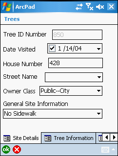

The Feature Properties dialog box will, by default, contain the Attributes, Picture, Symbology, and Geography pages. However, if a custom edit form exists for the particular layer then this form will be displayed as the first page, or pages, of the Feature Properties dialog box. The custom form designer may choose to hide any of the default pages. The example below shows a custom edit form with two custom pages: Site Details, and Tree Information. The name of the Feature Properties dialog box has also been renamed, to ‘Trees’, by the form designer.
You can create custom forms for shapefile and ArcPad AXF layers by using ArcPad Studio. These custom forms allow you to display attributes using common form controls—for example, text boxes, combo boxes, and check boxes—and incorporate additional data validation and initialization of attributes.

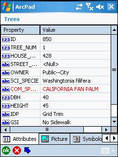

The Attributes page is used to display and edit the attributes and associated values of the selected feature. When accessed via the Identify tool, all values are read only. When accessed via the Feature Properties tool—or by double-tapping a feature with the Select tool—all values are read/write. An attribute that is used to define the symbology of the layer is displayed in red.
The Attributes page for shapefile features has two columns: Property and Value. The Property column corresponds to the field, or column, in the dBase table associated with the shapefile. The value column contains the value of the associated field or column. Tapping the value opens an edit box for editing the value entry.
With shapefiles, validation of the data entered is limited to adherence to the definition of the field or property. For example, ArcPad will not allow text characters to be entered into a field which has been defined as numeric. Additional validation can also be performed via custom forms and, in some cases, scripts.

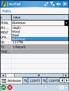

Tapping the value opens an edit box for editing the value entry, or activates a drop-down list to select from pre-defined valid values.
The value field for AXF layers and related tables may include built-in form controls—such as combo boxes (or pick lists)—if subtypes or coded value domains have been defined for the source geodatabase which the AXF layer was extracted from.

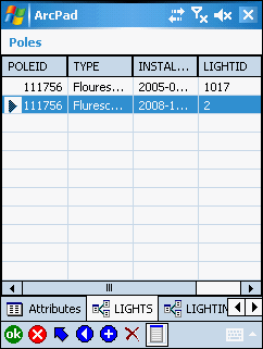

with another related table, then the parent page is this related table.The related table list view consists of a list of records and columns in the table, with one row per record. Rows or records can be added or deleted in the list view, but the record contents cannot be edited.
The list view has the following buttons at the bottom of the page (in addition to the previously described ok, Cancel, and Up buttons):
Moves the selection up one row
Moves the selection down one
row
Adds a new row and then
automatically switches to the single entry view.
Deletes the selected row
Switches to the single row
view.

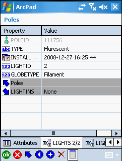

The single row view has two columns: Property and Value. The data can be edited in
the single row view. This view also includes rows for the parent table and any
secondary related tables. The Up
button can be used to easily navigate to the parent table,
while the Down
button can
be used to easily nagivate to any secondary related tables.

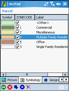

The Symbology page is used to view the symbols and labels defined in the ArcPad layer definition. The ArcPad layer file is created in ArcGIS Desktop using the ArcPad Data Manager. ArcPad assigns a random symbol for the layer if there is no symbology defined in the layer file. The symbol used by the currently selected feature is highlighted.
The Symbology page provides a visual method for selecting an attribute value. When a symbol, or category, is selected the associated property value is also selected for the current feature’s attributes. The example below shows the selection of the ZoneCode property equal to a value of 5. The Label text is for display purposes only, and is not saved in the feature’s attributes.
You can add a new category by tapping the
button at the bottom of the legend. Each new category consists
of a symbol, value, and label. You can also delete a category by selecting the
category and tapping the
button. Adding or deleting categories changes the symbology, or legend, used to
display the features in the associated feature layer—adding or deleting categories
has no impact on the attributes saved with features.
