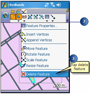

To delete a feature from the map and from your dataset, use the Delete Feature tool on the Feature Properties button dropdown list. ArcPad edits the original, or source, shapefile or AXF file; it does not operate on a copy of the file. Once a change has been committed, you cannot undo it.
When a feature is deleted, ArcPad converts the feature to a null shape and then subsequently ignores the null shape.
  1. Select the feature using one of the methods described earlier in this chapter.
  2. Tap the drop-down arrow below the Feature Properties button to display the drop-down list.
  3. Tap Delete Feature.
  4. Tap Yes to confirm that you really want to delete the selected feature.
    The selected feature is deleted.
