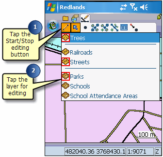

  1. Tap the Start/Stop Editing button on the Browse toolbar.
    A drop-down list displays all of the editable layers in the current ArcPad map, with a corresponding icon to indicate the type of layer.
  2. Tap the layer that you want to edit
    The Edit toolbar and the Command bar will be displayed if they are not already displayed.
    In order to select more than one layer you will need to repeat steps 1 and 2. You can select one point, one line, and one polygon layer for editing, at one time, or the graphics layer.
    A red box around the layer icon indicates that the layer has been selected for editing.
