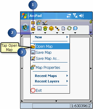

  1. Tap the open map button on the main toolbar.
  2. Alternatively, tap the dropdown arrow below the Open Map button on the Main toolbar to display the drop-down list.
  3. Tap Open Map. The Open Map dialog appears.

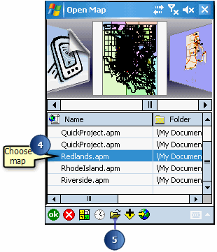

  4. On this page, choose from the list of maps you would like to open.
  5. Alternatively, you can tap the browse button and navigate to the location of your existing map file. Tap the map file you would like to open. ArcPad opens the selected map document.
