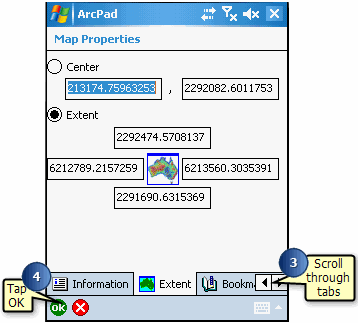

Tap the drop-down arrow below the Open Map button on the Main toolbar.
Tap Map Properties.
Scroll through the different tabs using the left and right arrow buttons. Set
your properties.
When finished, tap OK.
