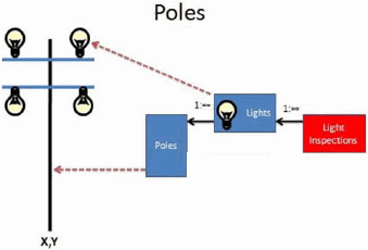

In this exercise you will use ArcPad and the ArcPad Data Manager for ArcGIS to conduct an electrical pole inspection. As in the real world, poles can have many attachments such as lights mounted on the poles. You will be inspecting the poles and the attached lights. There are two inspection relationships. The first relationship is for the pole itself: each pole can have multiple lights. The second relationship is for light inspections: each light can be inspected multiple times. Both of these relationships are referred to as a one-to-many relationship, or 1: α These relationships are illustrated in the following diagram:
