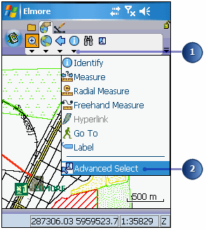

  1. With the Land Use layer in Edit mode, tap the arrow below the Identify tool, on the Browse toolbar.
  2. Tap Advanced Select.

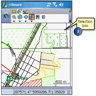

  3. Tap and drag a selection box to select all the fields in the vicinity of the vineyard. A list displays the selected features.
