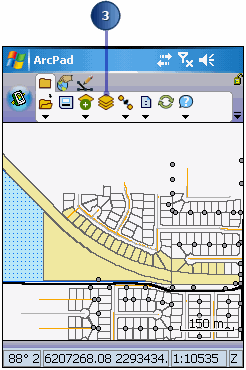

  1. Start ArcPad (on your Windows Mobile device or on your PC).
  2. In ArcPad, use the Open Map tool to navigate to the folder that you created in the previous task and to open the ArcPad map.

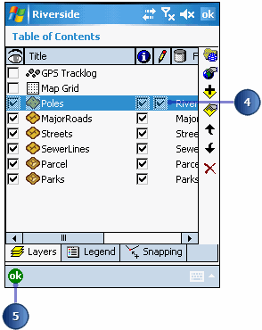

  3. Tap Table of Contents button on the main toolbar.
    Notice that only the Poles layer has a checkbox for editing as it was the only layer selected for editing in the Get Data For ArcPad tool in the previous task. All of the other layers were selected for display only, and as a result are read-only in ArcPad.
  4. Check the Edit checkbox for the Poles layer to select the layer for editing.
  5. Tap OK.

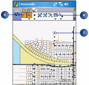

  6. Tap Select to activate the Select tool.
  7. Tap one of the Poles to select it.
  8. Tap the Properties tool to open the Feature Attributes dialog box.

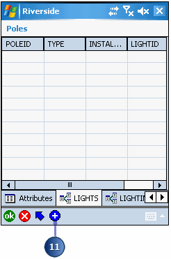

    There are no records in the Lights table—your task is to add a Light that is associated with the current selected pole.
  11. Tap the Add button to switch to the single row view that is used for adding and editing related table records.

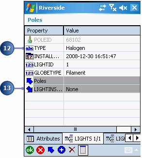

  12. Tap the Type property and enter ‘Halogen’ for the type of light. Also enter an InstallDate and a LightID.
  13. Tap the Down arrow to the left of the LightInspections relationship to go to the LightInspections page. Or, tap on the LightInspections tab of the Feature Properties dialog box.

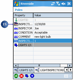

  14. On the LightInspections page, tap the Add button to switch to the single row view for entering information on the light inspection.
  15. Tap the InspectionDate property and select today’s date. Also enter data for Inspector, Condition, Comment, and InspectionID.
