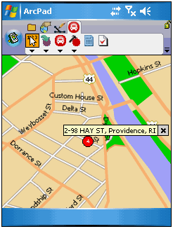

Your fourth stop is 48 Hay St, Providence.
  1. Tap the arrow below the Find Location button.
  2. Tap Find Address or Location
  3. Select Rhode Island (RI) from the State dropdown list.
  4. Type “p” in the city field and select 'Providence'
  5. Type “hay” in the street name field, and select 'Hay St' from the dropdown list.
  6. Select the range between 2-98 from the house list. It zooms to the stop desired.
  7. Click the Convert to Stop button to convert this new location to a stop.
    You have created four stops, so you are ready to move on to Exercise 3c.
