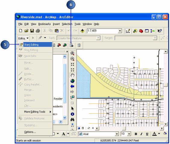

  5. Click Editor, and then click Start Editing to start an edit session for the Poles layer.
  6. Click the Get Data From ArcPad tool.

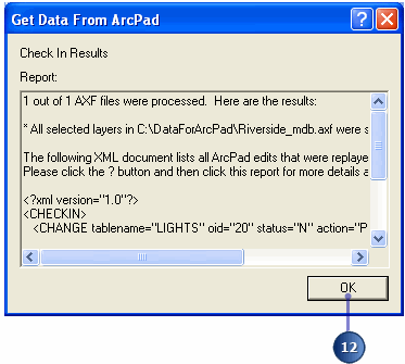

  12. A report is displayed with the results of the check in process. Click OK.

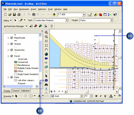

  14. Click on Identify to activate the tool.

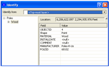

  15. Click on the pole that you edited in ArcPad to display the attributes for the selected pole.
  16. Tap the + box next to each branch to display all the attributes for the Pole feature class and the related tables.

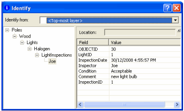

  17. Tap the LightInspections ObjectID to display the attributes for the light inspection. These are the attributes that you entered in ArcPad.
