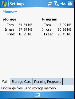

With Windows Mobile 5 (and later) devices, RAM is only available for running the operating system and programs. Windows Mobile 5 (and later) devices include non-volatile flash memory, or built-in storage, for installing application programs and data.
The above example shows the memory usage of a Windows Mobile 5 device, which has 54.84 MB built-in storage and 64 MB of RAM—of which 47.09 MB is available for running programs.
Storage cards—either flash memory or hard drives—can increase the amount of storage space for a Windows Mobile device, but they cannot increase the amount of memory available for running programs. Programs can only run in the memory installed on the device. It is therefore important to limit the amount of data and programs stored in RAM (for older devices) and in so doing maximize the amount of free memory available for running programs. Fortunately, an increasing number of Windows Mobile devices include built-in, nonvolatile, flash memory—in addition to ROM and RAM. For these devices it is recommended that applications, and optionally data, be installed in the built-in storage—keeping most of the RAM free for running the operating system and programs. Different Windows Mobile devices use different names for the built-in storage: Dell uses the name Built-in Storage, HP uses the name iPAQ File Store, Thales uses the name MyDevice, and Trimble uses the name Disk.
To view memory on a Windows Mobile device, tap Start>Settings>Control Panel, then double-tap the System icon to open the System Properties dialog box. Tap the Memory tab to open the Memory settings page
