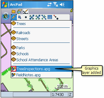

  1. Tap the drop down arrow below the Open Map button to display the drop down list.
  2. Tap New.
    The New submenu appears.
  3. Tap Graphics Layer.
  4. Type the name of the new graphics layer.
  5. Choose the folder and location where you want to save the new graphics layer.
  6. Tap Save to complete the task and create the new graphics layer.
    The graphics layer will be created, added to your map, and checked for editing.
