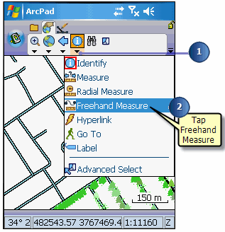

  1. Tap the drop-down arrow below the Identify button to display the dropdown list.
  2. Tap Freehand Measure.
    The Freehand Measure tool is activated, and the Freehand Measure button is depressed and promoted onto the toolbar. A red box around the Freehand Measure tool indicates that it is active.

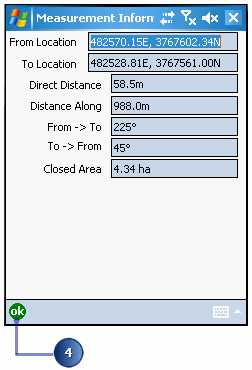

    ArcPad displays the Measurement Information dialog box with the following data: the coordinates (from and to location), the direct distance (from start to end), the actual distance drawn, the bearings, and the area.
  4. Tap OK to close the Measurement Information dialog box.
