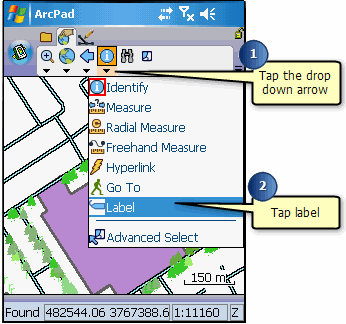

  1. Tap the drop-down arrow below the Identify button.
  2. Tap Label.
    The Label tool is activated, and the Label button is depressed and promoted onto the toolbar.

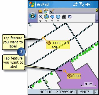

  3. Tap the feature that you want to label.
    ArcPad places a temporary label for the first feature that it finds.
    If needed, continue to tap additional features to label.
