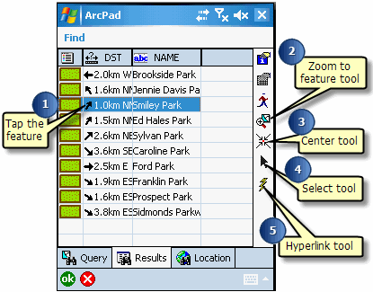

  1. Tap the feature you would like to query. Follow Steps 2, 3, 4, or 5, depending on what action you would like to perform.
  2. Tap the Zoom to Feature tool.
    ArcPad will zoom to the extent of the selected feature.
  3. Tap the Center tool.
    ArcPad will center the selected feature on the screen. The current map scale is maintained.
  4. Tap the Select tool.
    The feature is highlighted and selected.
  5. Tap the Hyperlink tool.
    The hyperlink for the feature is displayed if there is one.
