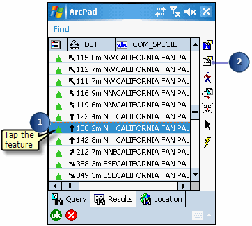

  1. Tap the feature for which you would like to display its properties.
  2. Tap the Feature Properties button.
    The Feature Properties dialog box or custom form displays, if one exists. The feature properties can be edited through this method. the layer must be set as editable in order for the Feature Properties button to be enabled.

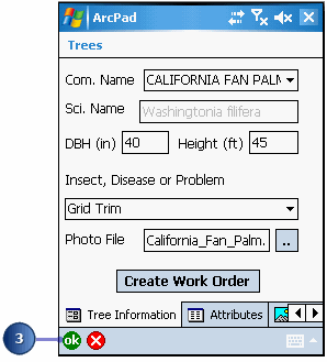

  3. Tap OK.
    ArcPad returns to the list of queried features.

    Editing with the Find tool: If the Feature Properties button is unavailable once you have selected your feature, you have not selected this feature to be editable via the Start/Stop Editing tool on the Browse toolbar or in the Table of Contents. You can only display and edit features with the Feature Properties dialog box once the layers have been made editable.
