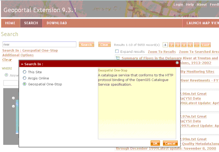

The second set of filters are used to define searching this Geoportal site, or a different catalog. To search a different catalog, click the "Search In:" link and select one of the listed catalogs or ArcGIS Online services on the list. For more information, see Directed Search.

Directed Search
Directed Search allows users to search many catalogs from within one Geoportal search interface. To use Directed Search, a user clicks the "Search In: This Site" link under the Search field on the Search page tab. Then the user selects one of the available catalogs. The "Search In:" link displays the selected catalog, and search results reflect records that are stored in that catalog. Note: Directed Search will only work with the catalogs that are exposed via CS-W.
