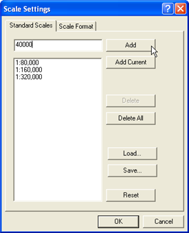

  1. Click the dropdown list of scales in ArcMap.
  2. Click <Customize this list>
  3. If you only want your scales to appear in the list, click Delete All.
  4. Type one of your scales in the box and click Add. Keep doing this until you've added all your scales and click OK.

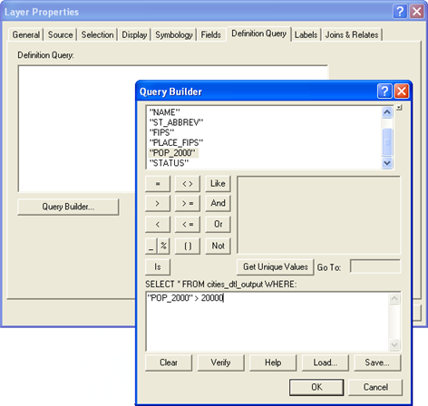

    Tip: You may want to set a definition query so that fewer features are visible at this scale. For example, if you have a cities layer, you can set a definition query that limits display to cities with a population greater than 20,000.

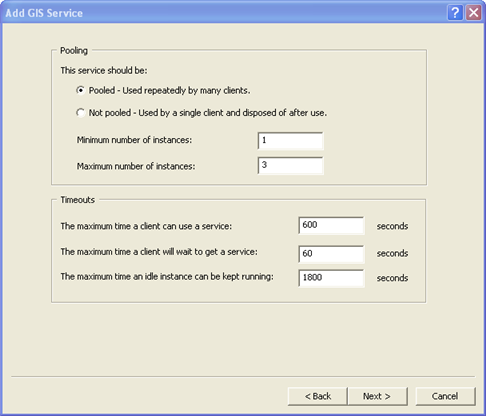

  7. Now you're on the page of the wizard where you can choose the pooling model and number of instances for the service. For cached services, you should always choose the default of Pooled. You can, however, raise or lower the Maximum number of instances to a number greater than 2.
    In most cases, a CPU can handle at least 3 instances while caching. More powerful machines, or configurations with multiple SOC machines, can handle even more instances. If you want to use all your server power in creating the cache or if you have a very large ArcGIS Server deployment, you should raise the default maximum number of instances.

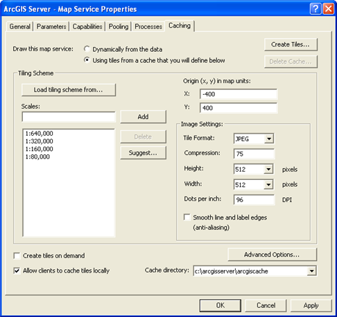

  1. In ArcCatalog, find your service in the Catalog tree. Right-click the service and click Service Properties.
  2. Click the Caching tab. Here is where you can access some of the cache properties. You will use this tab to configure the tiling scheme before you start creating cache tiles.
  3. Choose to draw the map service "Using tiles from a cache that you will define below".
  4. Type one of your scales in the Scales text box, then click Add. You should see the scale appear in the list.
  5. Continue entering scales and clicking Add for each one until you have reached the end of your list.
  6. Change the Cache Tile Format to JPEG. This format produces small tiles and will reduce the disk space needed to store the cache. Clients can also load the tiles quicker.
    Note: This step assumes that you are not going to overlay this cache on another service. For overlay services, such as road and boundary networks, you should choose PNG8 or PNG32 instead. Use PNG 32 if your overlay service has over 256 colors.
  7. You've now configured your tiling scheme (you'll use the defaults for all other properties). It's time to start creating tiles. Click Create Tiles.
  8. The Manage Map Server Cache Tiles tool appears with much of the required information already filled in. This is the tool you will use to create tiles. Take a moment to examine the tool's parameters.
  9. Change the Update Mode setting to Recreate All Tiles. You'll use this setting most often for creating and updating your caches.
  10. Optionally, change the Number of MapServer Instances setting. This number is a measure of the server computing power you want to dedicate toward creating your cache.
    If you want to dedicate all your resources to creating the cache, set a high number here. You can only set a number up to the Maximum number of instances property you set on the map service (see above instructions for Publishing the map service).
    If you only have one ArcGIS Server machine that needs to fill other requests while creating the cache, you might want to keep or decrease the default number of instances. This will ensure that the caching job does not consume all your server resources. Just remember that the fewer the number of instances you dedicate toward cache generation, the longer it will take to create the cache.
  11. You've filled in the essential properties for the tool, so click OK to begin generating the cache.

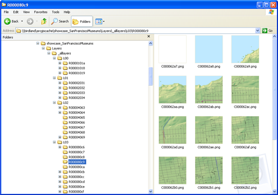

You can use Windows Explorer on Windows or navigate to the cache location on Linux/Solaris to get a rough view of the progress of the cache generation.
  1. On Windows, open Windows Explorer or My Computer. On Linux/Solaris, just switch to your cache directory.
  2. Navigate to your server cache directory.
  3. Navigate to <Service name>/<Data frame name>/_alllayers/L00. You'll see a few folders that represent the rows of the smallest scale in your cache. Expand one of these folders and you can see some of the actual cached images.
  4. Go back up to the _alllayers folder and examine the folders prefixed with L (L00, L01, and so on). These folders represent the different scale levels in your cache. The time stamp on the folder tells you when it was generated. Each successive scale level takes longer to generate because it contains more tiles. In this case, where you doubled the scale, each scale level contains four times as many tiles as the previous level.

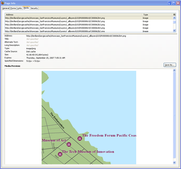

If you're using Mozilla Firefox to view your Web application, there's an easy way to tell if your cache tiles are being used.
  1. Click Tools and click Page Info.
  2. Click the Media tab.
  3. Examine the images that appear in the list. If you see images from your server cache directory (or its associated virtual directory), you know your cache is being used.
