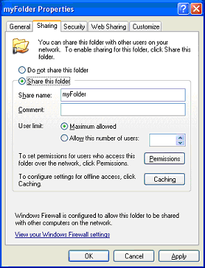

Each SOC machine in your system needs to be able to access the server directories. To make this possible, you can configure the folders representing your server directories to be shared, so that other machines on the network can access them. Suppose you have a folder on your hard drive at the path C:\ArcGIS\server_output which you want to make available to any computer on the network. You can share the folder and make it available to other users via a Universal Naming Convention (UNC) path. In the example above, for a machine named ‘myServer’, this path would take the form of \\myServer\server_output. Any machine on the network could access the folder using this naming convention.
You can share a folder in Windows by using the Sharing tab on the folder's Property page
When you choose to share a folder in Windows, you need to specify share permissions and file permissions (sometimes called NTFS permissions). Share permissions describe the levels of access different users will have to the folder. File permissions describe what the users can do with the folder’s contents. When a user attempts to access the folder, share permissions are considered first, followed by file permissions. In the case of conflict between the two permissions, the strictest permission is applied.

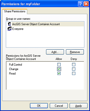

Grant share permissions to the server directories
For all server directories—cache, jobs, and output—you need to allow the SOC account at least Change level share permissions and the SOM account Full Control share permissions. You can set the share permissions in the folder’s Properties window. On the Sharing tab, click the Permissions button to view and edit the folder’s share permissions.
Granting share permissions in Windows XP

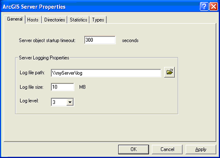

Specify the log directory location
Since the server log directory defaults to a local path, you need to change it to a UNC path when implementing a distributed installation. Instructions about sharing the log folder and granting it the appropriate permissions are available earlier in this document. You can specify the log directory location in Manager or ArcCatalog. At the initial release of ArcGIS Server 9.2, you must use ArcCatalog the first time you change the default log file location.
Specifying the log directory location in ArcCatalog

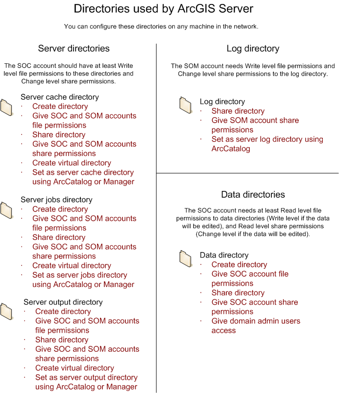

Appendix A: Accounts and permissions diagram
Setting up a distributed installation involves running post installs, creating users, and managing operating system groups on multiple machines. Below is a guide that shows what you’ll need to do on each machine. Each machine in the diagram contains some green text denoting which post install you must run on that machine. Items in blue are accomplished by the post install. Items in red are things that you must do. Note especially that you must manually add the ArcGIS Web services account on each dedicated SOC machine.
Appendix B: Directory diagram
ArcGIS Server uses various directories for reading and writing information. These directories:
This diagram displays the directories used by the GIS server, and the steps you need to take to configure them properly.
