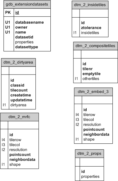

Being datasets, terrain datasets are managed in the geodatabase in the same tables as feature datasets, plus there are terrain-specific tables created in the schema of the user who created the terrain dataset. These tables are as follows:
dtm_<id>_compositetiles
Composite tiles are incomplete, in terms of data coverage, around their perimeter. They could be void of measurements entirely or within the proximity of one or more corners. To define a surface that covers the extent of these tiles data is used from surrounding tiles. This table is used to identify which tiles are composite tiles and what neighboring tiles provide data to complete them. One record is used per composite tile.
Field name Field type Description
id Int The unique identifier of the shape pointing to neighbor tiles.
Not null
tilenr Int The composite tile number. This is defined by the terrain's tile system.
A value of -1 is reserved for one record containing the centroids of the terrain's perimeter tiles.
Not null
emptytile Smallint A value of -1 indicates the tile is void of any measurements. A value of 0 indicates the tile has some data but is incomplete.
Not null
othertiles St_multipoint Multipoint shape storing the tile centroid of each surrouding tile that provides measurements to complete the composite tile.
dtm_<id>_dirtyarea
Dirty areas are tiles that have been invalidated as a result of edits to features in one or more participating feature classes. This table is used to keep track of these invalidated tiles and to record which in feature classes the edits have taken place. One record is used per feature class in which edits have been made. The table will be empty if no edits have been made.
id Int The unique identifier for the shape.
Not null
classid Int The class ID of the feature class that's the source of the edits.
Not null
tilecount Int The number of dirty tiles resulting from edits to the feature class.
Not null
dirtyarea St_multipoint Mutlipoint shape containing the tile centroids invalided as a result of edits to the feature class.
Not null
dtm_<id>_embed_#
Embed tables are used to store embedded multipoint feature classes. There may be 0..n embed tables. Their existance depend on whether the terrain has any embedded data. One table is used per embedded feature class. An embed table has the dual purpose of being part of the terrain's pyramid structure. The embedded data are grouped by tile and pyramid level.
Not null
tilerow Int The row number of the terrain tile to which the embedded points belong
tilecol Int The column number of the terrain tile to which the embedded points belong
resolution Decimal(32,8) Indicates in which pyramid level(s) the points are used
Since pyramid levels are cumulative, points participate in levels with resolutions equal to or greater than themselves
A special case involves the terrain overview. The resolution of the overview level is indicated with a value of -1. Points assigned this value participate through the entire pyramid.
pointcount Int The number of points in the multipoint
Not null
neighbordata Smallint Indicates whether points are inside the tile neatline boundary; Those outside are used to ensure complete coverage of the tile area. A value of 0 indicates the points are inside the tile. -1 indicates they are outside.
Not null
shape St_multipoint Embedded multipoint geometry
dtm_<id>_insidetiles
The InsideTiles table is used to record which terrain tiles are within the data area, or interpolation zone, of the terrain. This is recorded per pyramid level because it's possible for the extent to differ across levels (i.e. with the use of different clip polygon feature classes in different pyramid levels). One record is used per pyramid level. This includes both overview and full resolution levels.
Not null
ztolerance Decimal(32,8) The resolution of the pyramid level
A value of -1 indicates the overview level.
Not null
insidetiles St_multipoint Multipoint geometry storing the data tile centroids
dtm_<id>_mrfc
The MRFC is the pyramid structure for non-embedded feature classes. Mass points and breakline vertices for referenced feature classes are stored here under the pre-condition they participate in the full resolution pyramid level (they can also participate in other levels). Data are grouped by tile and pyramid level.
Not null
tilerow Int The row number of the terrain tile to which the pyramid points/vertices belong
tilecol Int The column number of the terrain tile to which the pyramid points/vertices belong
Since pyramid levels are cumulative, points participate in levels with resolutions equal to or greater than themselves.
Not null
neighbordata Smallint Indicates whether points are inside the tile neatline boundary; those outside are used to ensure complete coverage of the tile area. A value of 0 indicates the points are inside the tile. -1 indicates they are outside.
Not null
shape St_multipoint Multipoint geometry
dtm_<id>_props
The terrain props table is used to hold version specific properties for an individual terrain dataset. These include point count and extent. The information is stored in a BLOB and is not user accessible through the table. Instead, use terrain's ArcObjects API to access the information.
id Int The objectid for the record
Not null
properties Blob Stores the version specific dataset properties
A record is also created in the gdb_extensiondatasets table to track the terrain dataset. The id in the names of the dtm tables come from the id field of the gdb_extensiondatasets table.
As mentioned, terrain datasets are tracked with the same system tables as feature datasets. The additional tables for a terrain dataset are shown below. The 2 in the example DTM_* table names relates these tables to the id field in the gdb_extensiondatasets table.
Terrain dataset system tables in Informix
