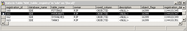

Versioned tables in a SQL Server DBMS
Internally, versioning is managed by a number of database tables: dataset tables, version delta tables, and system tables to track versions.
A versioned database typically contains a number of versions, in addition to the DEFAULT version, that might represent a work order, design alternative, disconnected editing session, historical snapshot, and so on. The SDE_versions table contains a descriptive list of these versions with each version identified by a unique name and ID (IDs are automatically generated by ArcSDE). In addition, each version has an owner, description, parent version, associated database state, and level of user access.
When the VERSIONS table is created, the details of the DEFAULT version are automatically recorded in this table. The ArcSDE administrator owns the DEFAULT version, and the initial ID of the corresponding database state is set to 0. The description string reads Instance Default Version, and as the DEFAULT version has been granted Public access, any user can modify it. To support general connections to the geodatabase, the level of access to the DEFAULT version must remain either Public or Protected; if the access level is set to Private, only the ArcSDE administrator can connect to the database.

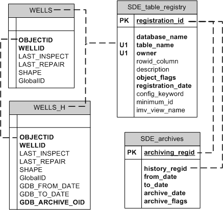

Archiving tables in a SQL Server DBMS
When a table is enabled for archiving, an archive class is created. This is a copy of the business table and contains all the same fields plus three new fields: GDB_FROM_DATE, GDB_TO_DATE, and GDB_ARCHIVE_OID. For a description of how these fields are populated, see The archive process.
The name of the archive class table is the same as the original business table name with an underscore and H appended to it. For example, if a feature class named trails is enabled for archiving, an archive class, trails_H, is created in the schema of the owner of the feature class. The archive class table is read only, stores changes saved or posted to the DEFAULT version of the geodatabase, and is not deleted if its corresponding dataset is unregistered as versioned or deleted. If an archived dataset is unversioned or deleted, the archive class is converted to a temporal table and can still be queried. See Working with the Geodatabase History Viewer for details on viewing different historical versions.
When changes are made to the schema of a dataset that is enabled for archiving—for example, if a field is added or deleted—these changes are automatically added to the corresponding archive class.
NOTE: Never directly alter the schema of an archive class.
Also, when a table is enabled for archiving, a record is added to the SDE_archives table. This record stores the registration IDs of the table that was enabled for archiving and its associated archive class table. For further information on the SDE_archives table, see System tables of a geodatabase in SQL Server.
The following shows a business table—WELLS—enabled for archiving, its corresponding archive class table, and records in the SDE_archives table.
Business table enabled for archiving and its associated history and SDE_table_registry table
