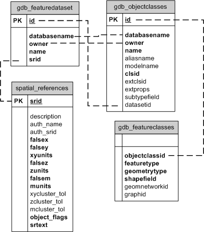

Feature datasets in an Informix DBMS
In the database, feature datasets are virtual collections of feature classes. They are grouped together by a common dataset ID, which is maintained in the gdb_featuredataset system table and associated with the gdb_objectclasses system table.
The following are the tables involved in a feature dataset:
Feature dataset system tables in Informix
For the USA feature dataset example, the feature class Cities would be linked to the USA feature dataset through the gdb_objectclasses table.
Because feature datasets are a virtual collection of objects, feature classes in feature datasets are just like stand-alone feature classes in that they have their own records in the gdb_featureclasses table and all the other tables associated with feature classes (such as layers, table_registry, geometry_columns, column_registry, and gdb_object_classes). Since feature classes associated with feature datasets are database objects in their own right, they cannot have the same name as other tables or stand-alone feature classes in the database.
Topologies, geometric networks, network datasets, and terrain datasets utilize additional system tables, which are described in separate topics.
