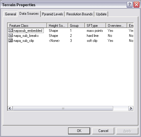

You can see two of the feature classes that participate in the terrain—napa_sub_breaks and napa_sub_clip. To find out if there are any embedded feature classes in the terrain dataset, check the terrain properties. Right-click the terrain, and click the Data Sources tab. This will list all feature classes used to create the terrain. In this example a third, embedded feature class—napasub_embedded—was used to create this terrain.
Feature classes used as the data source for a terrain

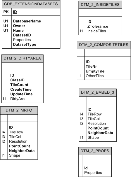

A record is also created in the GDB_EXENSTIONDATASETS table to track the terrain dataset. The ID in the names of the DTM tables come from the ID field of the GDB_EXTENSIONDATASETS table.
As mentioned, terrain datasets are tracked with the same system tables as feature datasets. The additional tables for a terrain dataset are shown below. The 2 in the example DTM_* table names relates these tables to the ID field in the GDB_EXTENSIONDATASETS table.
Terrain dataset system tables in SQL Server
