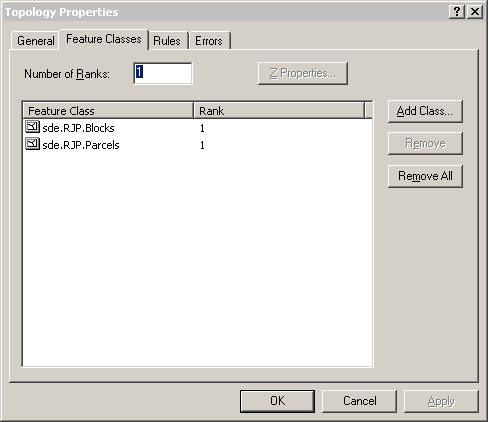

You can right-click the topology and click Properties to open the Topology Properties dialog box. The General tab lists the name of the topology and the cluster tolerance. You can click on the Feature Classes tab to see which feature classes within the feature dataset participate in this topology.
Clicking on the Rules tab will show you the rules that apply to the topology. After the topology has been validated, you can generate a list of the errors and exceptions for each rule from the Errors tab.
