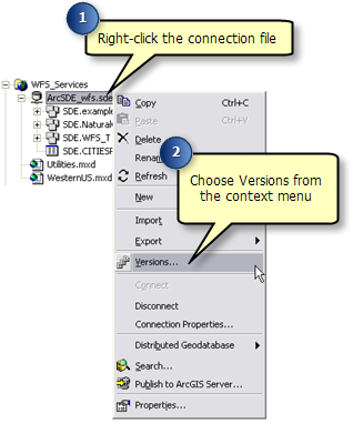

  3. Now that the data is versioned, you must dedicate a version specifically for WFS users to edit. If no such version exists, follow these steps to create a new version for WFS editors to work with. Right-click on the connection file and select Versions.
    This opens the version manager dialog.
  4. In the version manager dialog, right-click on the version you wish to create a child version of and click New. This creates a new version that can be used by WFS editors.

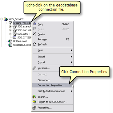

    To do this, right click on the geodatabase connection file and choose Connection Properties.

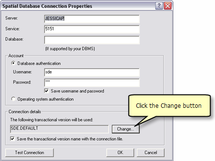

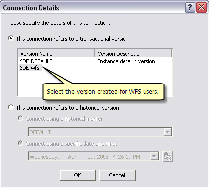

  8. Under the section Connection Details click the Change button
  9. Select the version dedicated to WFS users and click OK

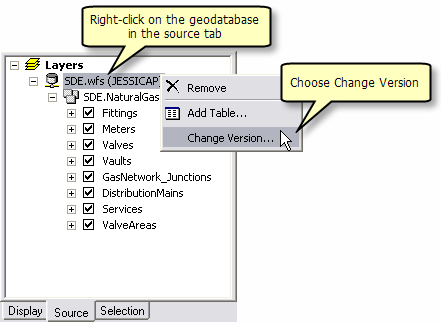

  11. To ensure that the map service publishes the appropriate data when it is created, your map document must be updated so that it references the newly created WFS version.To do this, click on the Source tab in the table of contents
  12. Right click on the geodatabase and select Change Version. This opens the Version Manager dialog.
  13. In the Version Manager dialog select the version dedicated to WFS users and click OK.

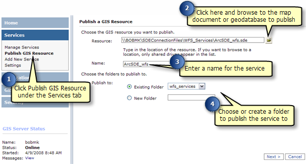

  1. Click Publish a GIS Resource under the Services tab.
  2. To select the Resource, use the dropdown box to browse to the map document (.mxd) or geodatabase (personal, file or SDE connection file(.sde)) that you want to publish.
  3. In the Name box, type a name for the service. The name cannot be more than 120 characters long, and may contain only alphanumeric characters and underscores.
  4. There are three options of which folder to publish the service to;
    • You can use the dropdown menu to choose an existing folder
    • Create a new folder
    • Accept the default folder, this will publish to the root folder
    After choosing where to publish the service, click next to continue.

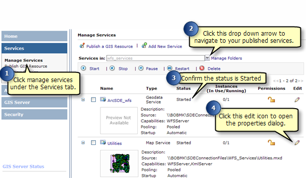

  1. Under the Services tab in ArcGIS Server Manager, click Manage Services.
  2. Click the Services in dropdown arrow and navigate to the service folder containing your published service.
  3. Your service may be listed with its Status as Started. In order to change settings on your service the service must be stopped. If the status is shown as Started, click the check box beside your service and then click the Stop button.
  4. Click the Edit icon to open the properties dialog.
  5. In the properties dialog select the Capabilities tab
  6. Click the WFS option (the name not the check box) under the Select and configure capabilities window. This will display the WFS service properties.
  7. Click the Enable Transactions check box.

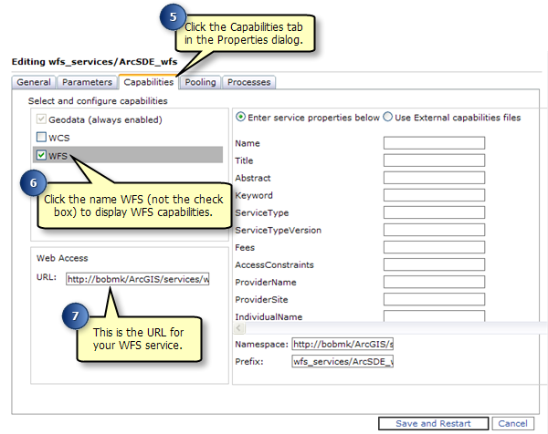

  4. To acquire the URL for your WFS service, click the edit icon to open the properties dialog.
  6. Highlight the WFS option under the Select and configure capabilities window. This will display the WFS service properties.
  7. The URL for your WFS service is located in the Web Access window. This is the URL that you and other users will use to connect to the WFS service you have published.

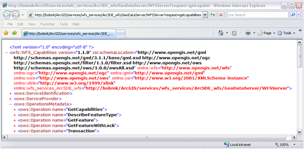

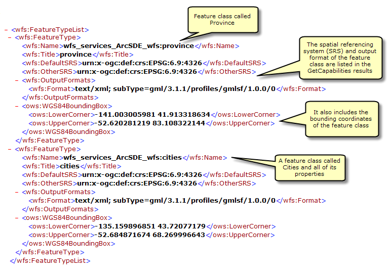

GetCapabilities
This request will return all feature types and functionality available through the service in GML format. To use the GetCapabilities operation in a web browser copy and paste the WFS URL into the address bar and add "?request=getCapabilities" to the end, as shown in the example and screen shot below.
URL example: http://bobmk/arcgis/services/wfs_services/ArcSDE_wfs/GeoDataServer/WFSServer?request=getcapabilities

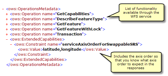

The following graphic is an example of functionality returned by the GetCapabilities operation:
GetCapabilities also returns a list of all available feature classes and tables:

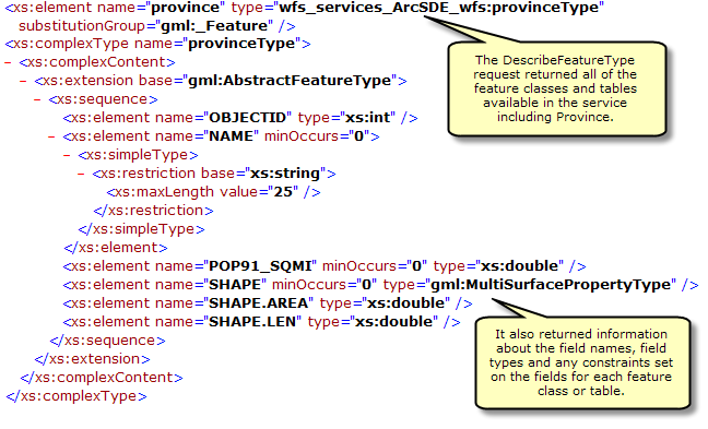

DescribeFeatureType
This request describes the field information about one or more features in the WFS service. This includes the field names, field types, allowed minimum and maximum field values and any other constraints set on a field of the feature classes or tables.
To use the DescribeFeatureType operation in a web browser copy and paste the WFS URL into the address bar and add "?SERVICE=WFS&VERSION=1.1.0&REQUEST=DescribeFeatureType&VERSION=1.1.0" to the end of the URL. This will return all of the field information about each of the feature types and tables available in the feature service, as seen in the screen shot below.
URL Example: http://bobmk/arcgis/services/wfs_services/ArcSDE_wfs/GeoDataServer/WFSServer?SERVICE=WFS&VERSION=1.1.0&REQUEST=DescribeFeatureType&VERSION=1.1.0
Adding filters

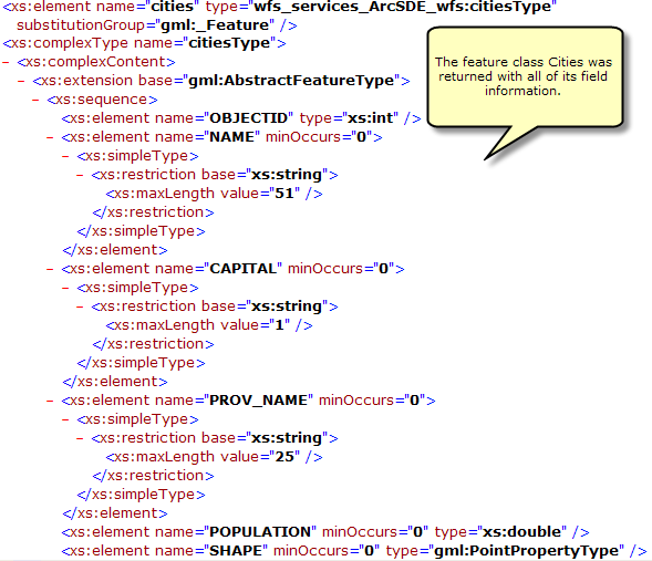

You can also specify a single feature class or table that you want the field information for by appending the following request to the end of the URL with the name of the feature type or table. "?SERVICE=WFS&VERSION=1.1.0&REQUEST=DescribeFeatureType&TypeName=[enter feature type here]&VERSION=1.1.0"
In the example below the DescribeFeatureType request is used to identify the field information for the feature type called cities.
URL example: http://bobmk/arcgis/services/wfs_services/ArcSDE_wfs/GeoDataServer/WFSServer?SERVICE=WFS&VERSION=1.1.0&REQUEST=DescribeFeatureType&TypeName=cities&VERSION=1.1.0

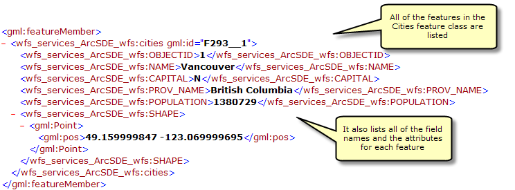

GetFeature
This request returns information about specific feature types available through the WFS service. Additionally, filters can be used to refine the information that is returned. For more information about the different filters available with WFS services see WFS Services.
To use the GetFeature operation in a web browser copy and paste the WFS URL into the address bar and add "?request=getFeature&typename=[enter feature type here]" to the end of the URL. This will return all of the attribute and geometry information about each feature or row in the feature type.
URL example: http://bobmk/arcgis/services/wfs_services/ArcSDE_wfs/GeoDataServer/WFSServer?request=getfeature&typename=cities

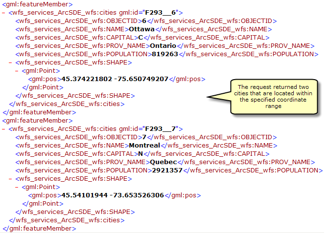

You can also add filters in the request to refine the results that are returned. For example you can request all of the cities that are within a specified coordinate range. In the example below two cities are located within a specified coordinate range.
URL Example: http://bobmk/arcgis/services/wfs_services/ArcSDE_wfs/GeoDataServer/WFSServer?request=getfeature&typename=cities&BBOX=46.90,-76.21,42.12,-72.88

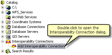

  2. Open the Interoperability Connections tool and double-click on the Add Interoperability Connection tool. This will open the Interoperability Connection dialog box.

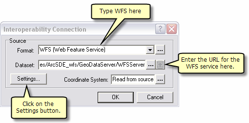

  3. In the Interoperability Connection dialog, select WFS from the Format dropdown menu. In the Dataset edit box enter the URL for the WFS service that you want to connect to and click on the Settings button, this will bring up a WFS dialog.

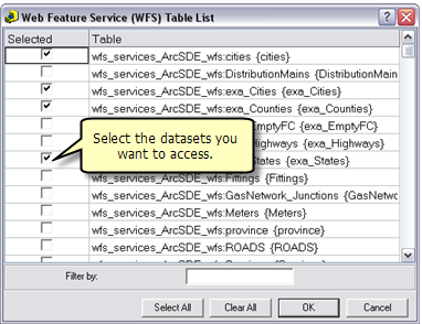

  4. The WFS dialog allows you to specify connection information and select the feature types that you want to have visible through the connection. Click on the Table List button.
  5. In the Table List dialog select the features that you want to include in the connection and click OK.
  6. Click OK again to close the Settings dialog and then again to close the Data Interoperability dialog.

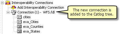

  7. Your new connection should now appear underneath Interoperability Connections in the Catalog Tree and is now available for use throughout ArcGIS.

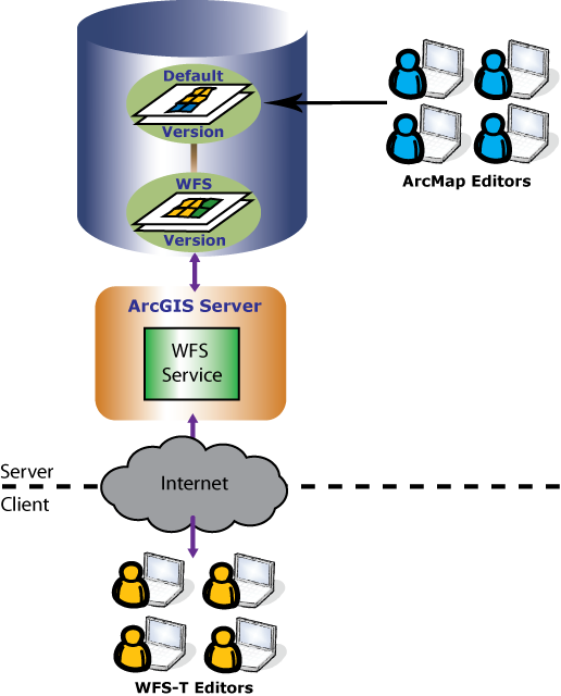

It is important to create an efficient workflow for managing edits made through a WFS-T service. Assuming you have followed the recommended method of creating a separate WFS version for WFS-T editors to work with, the system that you have set up should look similar to the diagram below:
In this example, WFS-T editors and ArcMap editors use versions so that each group can have their own isolated view of the geodatabase to work with. ArcMap editors are directly editing the Default version through ArcMap. WFS-T editors are accessing the WFS service over the internet. This allows WFS-T editors to make edits on the WFS version that was created as a child of Default. To learn more about versions, see Understanding versioning in the desktop help system.
To keep the two versions in sync, a process can be run regularly to update the WFS version with edits from the Default version, and also to update the Default version with the edits from the WFS version. This is a two step process in the editing workflow of any versioned system called reconcile and post. This process can be automated or it can be administered by an editor (depending on their permissions) or database administrator. To learn more about the reconcile and post process see An Overview of the version editing process

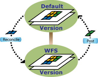

When run, the reconcile operation will pull updates from the Default version into the current editing session on the WFS version. Conflicts may occur if edits have been made to the same features in both versions. You can either setup conflict resolution to be automatic, or you can choose to resolve each conflict manually through the conflict resolution dialog.
After handling any conflicts the post operation can be run. This process merges changes from the WFS version into the Default version
The whole reconcile and post process is summarized in the diagram below. Here the WFS version pulls updates from the Default version during reconcile. After incorporating the changes, the WFS version posts its updates to the Default version using the post operation. At this point the Default and WFS versions both have the same content.
Once the reconcile and post process is complete, both versions are up to date with the most current representation of the features, and WFS editors can continue making edits again.
