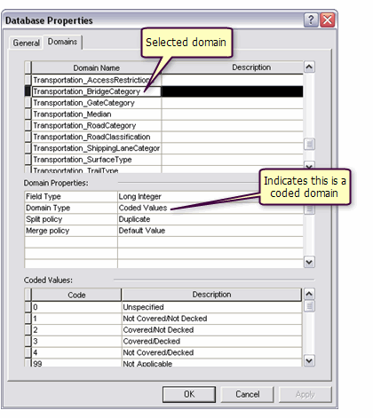

The domains for a geodatabase are accessed in ArcCatalog by way of the Database Properties dialog box. Right-click the geodatabase and click Properties.
In the example above, all the domains defined for a geodatabase are listed at the top of the dialog box. The Transportation_BridgeCategory domain is selected in the list. The domain properties and coded values shown pertain to this selected domain. As shown in the Domain Properties list, the Transportation_BridgeCategory domain is a coded domain.

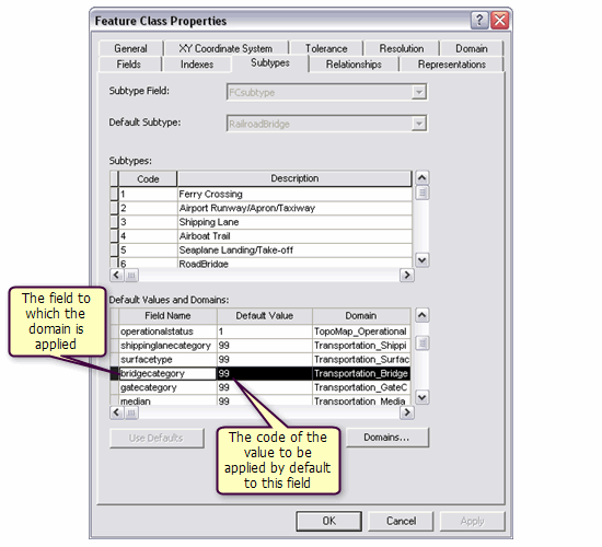

When a domain is applied to a subtype, it is listed on the Subtype tab of the Feature Class Properties dialog box. Right-click the feature class and click Properties.
The Transportation_BridgeCategory domain is being applied to the bridgecategory field of the TransportationL feature class.
When you edit the attributes of the TransportationL feature class in ArcMap, you are only able to enter one of the codes specified for the Transportation_BridgeCategory domain in the bridgecategory field.

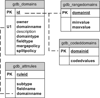

In the database, domains are stored in the system tables gdb_domains. Coded domains are tracked in the gdb_codeddomains system table, and range domains are tracked in the gdb_rangedomains system table.
The gdb_fieldinfo system table stores one record for every field in every user-defined table in the geodatabase. This table also stores the name of the domain (if any) that is associated with each field.
The gdb_attrrules table stores the name of a field, the name of the domain associated with that field, the subtype code for the feature class, and the rule ID.
The following are the domain system tables. Dashed lines indicate an implicit relationship between tables.
