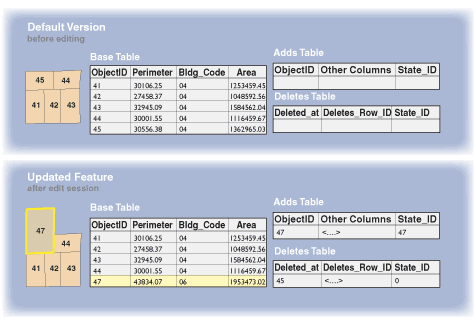

Version tables in the geodatabase
In the example above, a parcel (number 45) is updated to become parcel number 47. Using versioning, the original parcel is saved in the Deletes table and the new parcel is saved in the Adds table. Other meta tables record version information about the transaction such as the time and sequence of each update, the version name, and the state ID of each update. Each version also has its own security and access privileges.
This enables most users to work with the default version while various editors are simultaneously making updates against their own versions of the database over time.
Numerous updates can be made against each version, and users connect to and work with the update version as they make additional edits to the data. When users are ready to share the updates with the rest of the enterprise, a reconcile and post operation is performed to commit the edits held in the update version to the main (Default) version. A resolution process is used to identify and reconcile any potential conflicts during this process.
