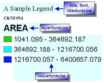

When parent element is PROPERTIES and using ArcMap Server:
AttributeUsage
autoextendExtends the legend to accommodate information for all layers. Should always be set to "true" with ArcMap Server.
backgroundcolorLegend?s background color using RGB values.
displayTurns legend on or off.
fontFont for title. The name is case sensitive. If font name uses "&", use "&amp;" instead. For example, ESRI Transportation & Civic should be written as ESRI Transportation &amp; Civic.
layerfontsizeFont size for the layer labels.
swatchheightHeight of the symbol swatch in pixels.
swatchwidthWidth of the symbol swatch in pixels.
titleTitle of legend.
titlefontsizeFont size for the legend title.
valuefontsizeFont size for the value map labels.
