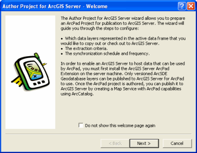

When you choose to run this tool, the 'Welcome screen' appears.

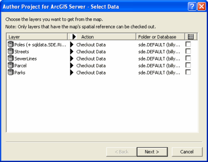

If you do not want the welcome page to appear again, check the checkbox saying 'Do not show this welcome page'. Click 'Next' and the following screen appears.
Layer
Displays the name of the layer. Relationship classes for geodatabase layers are also displayed together with the layer name.
Action
On the action tab you have an option of setting the action on an individual layer or you can choose to set the same settings for all the layers. When you click on the Action tab, the following list appears.
Folder or Database
Displays the folder or the geodatabase where the layer is located.
Layer Definition Template
When checked, the Open Layer dialog is displayed allowing you to choose an existing Layer Definition from a shapefile or ArcPad AXF file to be used as a template. This allows you to re-use forms, scripts, icons, and other layer definition elements.
Spatial extent
Select the spatial extent to be used for selecting the layer features to be copied or checked out. Raster layers will also be cropped to the selected spatial extent unless the Keep Original image output option is selected.
Once layers are selected on this screen, click 'Next'. The next page of the wizard is Select Output Options.
