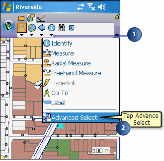

  1. Tap the drop-down arrow below the Identify button to display the drop-down list.
  2. Tap Advanced Select.

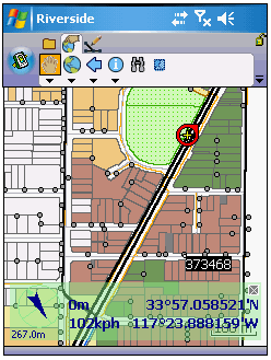

  6. Tap the Go To button to make the selected feature your destination.
  7. The destination is displayed and labeled with the same feature attribute shown in the Advanced Select list.
  8. Use the GPS Position Window to view the distance (DST) and bearing (BRG) from your current GPS position to your selected destination.
