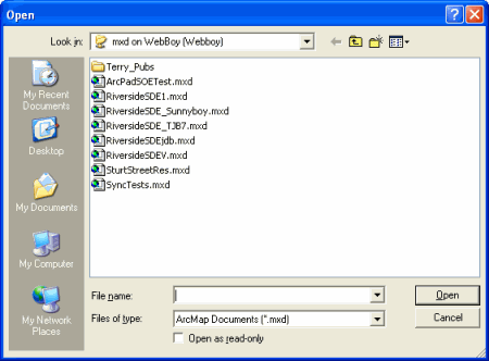

  1. On your PC, start ArcMap by clicking Start > All Programs > ArcGIS > ArcMap. When the first screen comes up, from the File menu click Open and the following dialog appears.
  2. Navigate to a Map Document which you created in the previous exercise, and open it in ArcMap. The ArcPad Data Manager toolbar should already be activated. If the toolbar is not active, it can be done so by selecting the ArcPad Data Manager extension in the Tools > Extensions dialog box

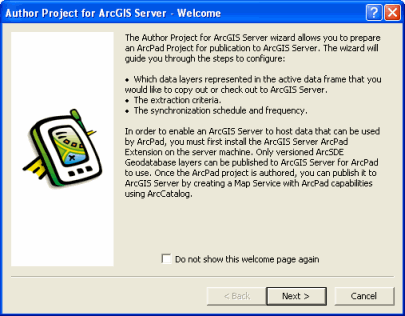

  3. Click the 'Author Project for ArcGIS Server' tool and the Welcome screen appears.
    If you do not want the welcome page to appear again, check the checkbox saying 'Do not show this welcome page'.

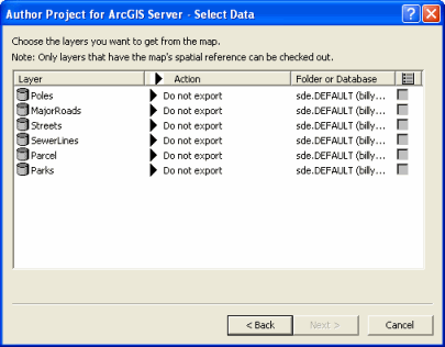

  4. Click 'Next' and the following screen appears.

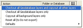

  5. Click the title ‘Action’ and choose to check out all geodatabase layers for editing, as shown below

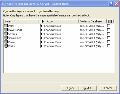

    All the layers will now have the action 'checkout data', as shown below.

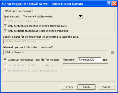

  6. Click 'Next' and the following screen appears. On the 'Select Output Options' page of the wizard, select the output options as required.
  7. Once the output options are selected, click 'Finish', and the following screen appears.
    The configuration you selected for your ArcPad project is saved and ready to be published to ArcGIS Server.
