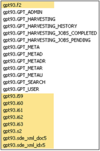

    After starting the metadata service, you may notice that additional tables exist in your Geoportal database as well. Examples of these tables are shown highlighted in the graphic below. These are tables that sde maintains and references in the database. The functions of these tables and their column values are not outlined in this document, but these tables are necessary for the proper functioning of the Geoportal. Do not delete them.
    Because there are connections to SDE, it is important to use ArcCatalog if the database or tables within it ever need to be deleted. Deleting tables through ArcCatalog ensures that any references to SDE tables are also deleted, whereas dropping the database through sql commands does not always delete these references.
