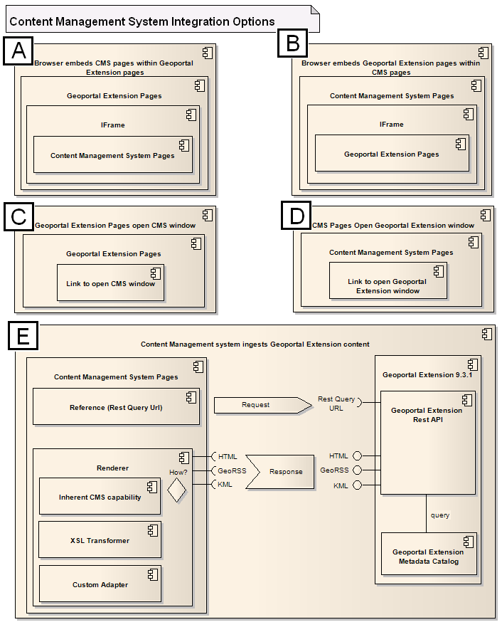

A Content Management System (CMS) is software that allows users to enter and change content on a website. There are a number of CMS available, and the Geoportal can be integrated within a CMS, or a CMS can be integrated within the Geoportal extension as a new tab. A CMS is not a requirement of the Geoportal extension, but integrating one can give a more directed view of the content of the geographic metadata catalog. CMS pages can highlight sets of geographic data and services that are applicable to certain user groups or topics. Several options are available for CMS integration, as illustrated in the figure below:
- Option A - A browser can embed CMS web pages within Geoportal extension web pages through an HTML <iframe> tag. A typical approach would involve adding a tab to the Geoportal extension user interface that references a CMS starting page.
- Option B - Conversely, a browser can embed Geoportal extension web pages within CMS web pages through an HTML <iframe> tag. A typical approach would involve adding a tab to the CMS user interface that references a Geoportal extension starting page.
- Option C - Geoportal extension web pages could simply launch the CMS in a separate window by adding an HTML <a> tag to the Geoportal extension user interface.
- Option D - CMS web pages could simply launch the Geoportal extension in a separate window by adding an HTML <a> tag to the CMS user interface.
- Option E - The CMS could also ingest targeted content through the Geoportal extension's Rest API. The Rest API allows for the submission of catalog query requests through a simple URL, and can return the results of the query in HTML, HTML fragment (no <html> header tag), GeoRSS or KML format.
As an example:
http://host:port/[Geoportal ExtensionApplicationName]?seatchText=maps&f=georss&max=100
This example search would be executed against the term "maps" and a GeoRSS response would be returned with a maximum of 100 records. The CMS would then render the response.
The methodology for rendering the response within a CMS page can vary. Some systems have inherent capability to render one or more of the response formats provided by the Geoportal extension. Another approach involves transforming a response using XSL technology; this gives full control over the look and feel of the rendered response content. Implementing this approach will depend upon the capabilities of the CMS. Many content management systems also provide the ability to plug-in customized rendering adapters. This approach would involve the development of the custom component.

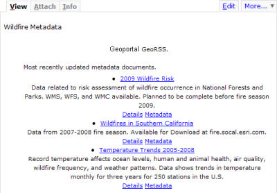

- Go to the edit mode of the page, and paste the string below into it. This change will insert GeoRSS feeds from your Geoportal. In the string, the url attribute should reference the REST result string for the search you want to display on the wiki page. For example, if you want the wiki page to display the wildfire records, the url parameter would look like the one in the example below. The parameters such as "detail", "ttl", "date", and "maxitems" are parameters defined by the plugin, and can be adjusted according to the syntax documentation on the RssViewerPlugin page:
[{fr.univ.reunion.iremia.rss.RssViewer url='http://yourGeoportalserver/geoportal/rest/find/document?searchText=wildfire' detail='1' ttl='120' date='1' maxitems='20'}]
- You can define more complex search results by using the REST syntax to specify extent, topic categories, dates, and more.
- Save the wiki page, exit the edit mode, and you will see the page like below:

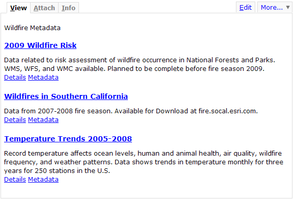

- Paste the string below into it. Note, the parameter called "xml=" will need to have the URL of your search result page for the Geoportal REST API results, and the "xsl=" parameter will need to reference the URL to your published IdentityTransform.xsl.
[{INSERT net.panonet.XSLTPlugin WHERE xml='{url to document (or search result page) of Geoportal REST API}', xsl='{url to IdentityTransform.xsl}'}]
For example:Wildfire Metadata
[{INSERT net.panonet.XSLTPlugin WHERE xml='http:// yourGeoportalserver /geoportal/rest/find/document?searchText=wildfire*', xsl='C:/Tomcat5526/webapps/JSPWiki/channelPage.xsl'}]
- Save the page, exit the edit mode, and you will see the page like the following below:
