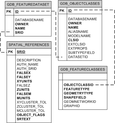

Feature datasets in an Oracle DBMS
In the database, feature datasets are virtual collections of feature classes. They are grouped together by a common dataset ID, which is maintained in the GDB_FEATUREDATASET system table and associated with the GDB_OBJECTCLASSES system table. The dashed lines indicate an implicit relationship between tables.
For the Landuse feature dataset example, the feature class SubParcels would be linked to the Landuse feature dataset through the GDB_OBJECTCLASSES table.
Because feature datasets are a virtual collection of objects, feature classes in feature datasets are just like stand-alone feature classes in that they have their own records in the GDB_FEATURECLASSES table and all the other tables associated with feature classes (such as LAYERS, TABLE_REGISTRY, GEOMETRY_COLUMNS, COLUMN_REGISTRY, and GDB_OBJECT_CLASSES). Since feature classes associated with feature datasets are database objects in their own right, they cannot have the same name as other tables or stand-alone feature classes in the same schema in the database.
Topologies, geometric networks, network datasets, and terrain datasets utilize additional system tables. These will be described in the corresponding sections that follow.
