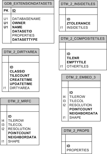

A record is also created in the GDB_EXENSTIONDATASETS table to track the terrain dataset. The ID in the names of the DTM tables come from the ID field of the GDB_EXTENSIONDATASETS table.
As mentioned, terrain datasets are tracked with the same system tables as feature datasets. The additional tables for the napa_sub terrain dataset (stored in a binary geometry storage type) are a shown below. The 2 in the example DTM_* table names relates these tables to the ID field in the GDB_EXTENSIONDATASETS table.
Terrain system tables in Oracle
