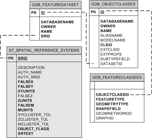

Feature datasets in a DB2 DBMS
In the database, feature datasets are virtual collections of feature classes. They are grouped together by a common dataset ID, which is maintained in the GDB_FEATUREDATASET system table and associated with the GDB_OBJECTCLASSES system table.
For the Landbase feature dataset example, the feature class Parcels would be linked to the Landbase feature dataset through the GDB_OBJECTCLASSES table. The ST_SPATIAL_REFERENCE_SYSTEMS table is a view and is shown in gray to differentiate. Dashed lines indicate implicit relationships between columns.
Feature dataset system tables in DB2
Because feature datasets are a virtual collection of objects, feature classes in feature datasets are just like stand-alone feature classes in that they have their own records in the GDB_FEATURECLASSES table and all the other tables associated with feature classes (such as LAYERS, TABLE_REGISTRY, GEOMETRY_COLUMNS, COLUMN_REGISTRY, and GDB_OBJECT_CLASSES). Since feature classes associated with feature datasets are database objects in their own right, they cannot have the same name as other tables or stand-alone feature classes in the same schema in the database.
