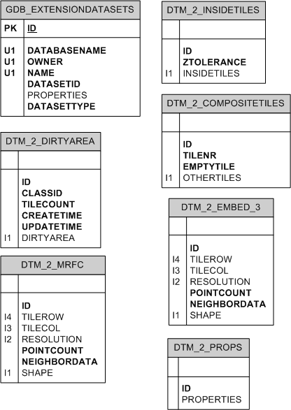

| Field name | Field type | Description |
| ID | INTEGER | The unique identifier of the shape pointing to neighbor tiles. NOT NULL |
| TILENR | INTEGER | The composite tile number. This is defined by the terrain's tile system. A value of -1 is reserved for one record containing the centroids of the terrain's perimeter tiles. NOT NULL |
| EMPTYTILE | SMALLINT | A value of -1 indicates the tile is void of any measurements. A value of 0 indicates the tile has some data but is incomplete. NOT NULL |
| OTHERTILES | ST_MULTIPOINT | Multipoint shape storing the tile centroid of each surrouding tile that provides measurements to complete the composite tile. |
| ID | INTEGER | The unique identifier for the shape. NOT NULL |
| CLASSID | INTEGER | The class ID of the feature class that's the source of the edits. NOT NULL |
| TILECOUNT | INTEGER | The number of dirty tiles resulting from edits to the feature class. NOT NULL |
| DIRTYAREA | ST_MULTIPOINT | Mutlipoint shape containing the tile centroids invalided as a result of edits to the feature class. NOT NULL |
| ID | INTEGER | The unique identifier for the shape NOT NULL |
| TILEROW | INTEGER | The row number of the terrain tile to which the embedded points belong |
| TILECOL | INTEGER | The column number of the terrain tile to which the embedded points belong |
| RESOLUTION | DECIMAL(31,8) | Indicates in which pyramid level(s) the points are used Since pyramid levels are cumulative, points participate in levels with resolutions equal to or greater than themselves A special case involves the terrain overview. The resolution of the overview level is indicated with a value of -1. Points assigned this value participate through the entire pyramid. |
| POINTCOUNT | INTEGER | The number of points in the multipoint NOT NULL |
| NEIGHBORDATA | SMALLINT | Indicates whether points are inside the tile neatline boundary; Those outside are used to ensure complete coverage of the tile area. A value of 0 indicates the points are inside the tile. -1 indicates they are outside. NOT NULL |
| SHAPE | ST_MULTIPOINT | Embedded multipoint geometry |
| ZTOLERANCE | DECIMAL(31,8) | The resolution of the pyramid level A value of -1 indicates the overview level. NOT NULL |
| INSIDETILES | ST_MULTIPOINT | Multipoint geometry storing the data tile centroids |
| TILEROW | INTEGER | The row number of the terrain tile to which the pyramid points/vertices belong |
| TILECOL | INTEGER | The column number of the terrain tile to which the pyramid points/vertices belong |
| RESOLUTION | DECIMAL(31,8) | Indicates in which pyramid level(s) the points are used Since pyramid levels are cumulative, points participate in levels with resolutions equal to or greater than themselves. A special case involves the terrain overview. The resolution of the overview level is indicated with a value of -1. Points assigned this value participate through the entire pyramid. |
| NEIGHBORDATA | SMALLINT | Indicates whether points are inside the tile neatline boundary; those outside are used to ensure complete coverage of the tile area. A value of 0 indicates the points are inside the tile. -1 indicates they are outside. NOT NULL |
| SHAPE | ST_MULTIPOINT | Multipoint geometry |
| ID | INTEGER | The ObjectID for the record NOT NULL |
| PROPERTIES | BLOB | Stores the version specific dataset properties |
