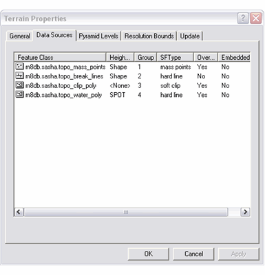

You can see the feature classes that participate in the terrain—topo_break_lines, topo_clip_poly, topo_mass_points, and topo_water_poly. To find out if there are any embedded feature classes in the terrain dataset, check the terrain properties. Right-click the terrain and click the Data Sources tab. This lists all feature classes used to create the terrain. In this example, no embedded feature classes were used to create this terrain. If there had been, an additional feature class that was not visible in the feature dataset in the Catalog tree would have been listed and contained a Yes value in the Embedded column of the Terrain Properties dialog box.
Terrain Data Source properties

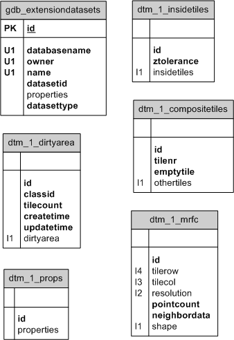

As mentioned, terrain datasets are tracked with the same system tables as feature datasets. The additional tables for a terrain dataset are shown below. The 1 in the dtm table names is the value in the id field of the gdb_extensiondatasets table.
System tables for a terrain in PostgreSQL
NOTE: Since there were no embedded feature classes in the dataset, a corresponding dtm_1_embed table was not created.
